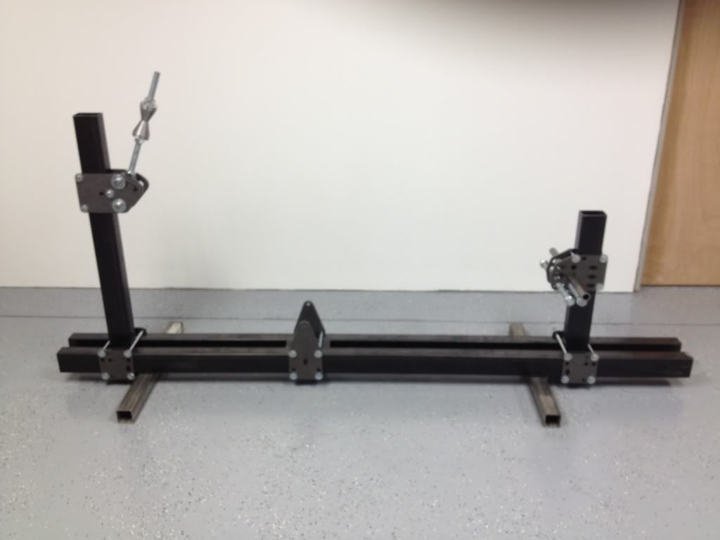

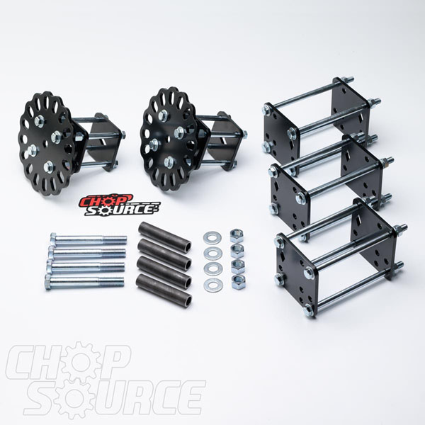

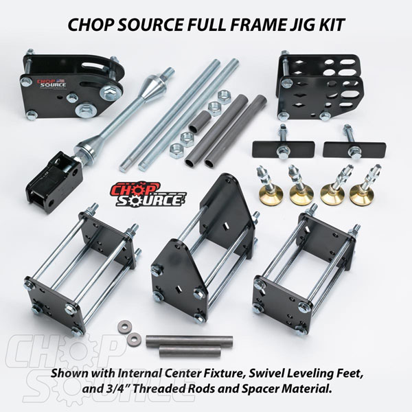

Hey guys, the frame jig kits are ready! The entire kit bolts together so you can break it down and store it easily when you aren't using it. No welding required except when adding leveling feet (see below). The neck will accommodate rakes from 15 degrees to 60 degrees. You need to supply about 17.5' of 2"x3" rectangle tube (1/8" wall) for the main part of the jig. The kit is designed to work with 2"x2" square tube as well. You also need 40" of tube for the feet. Structural tube can be found at local metal supply shops or at welding/fabricating shops.
This is the standard kit:

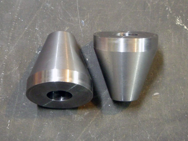

The basic kit now comes with everything in the picture below plus a pair to neck centering cones:

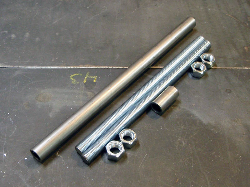

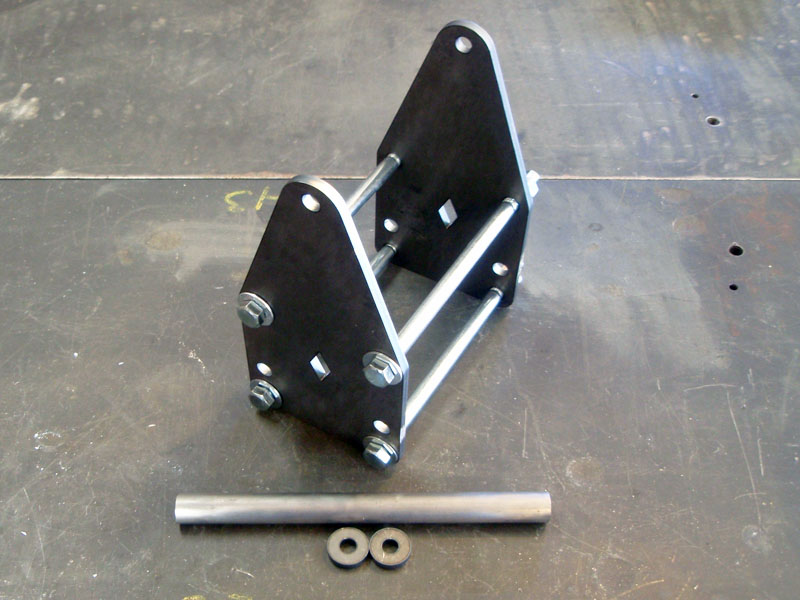

The motor mounts on the lower rails of the frame attach to this fixture. The spacer material provided is long enough to work with many different frames. You'll need to cut down the spacer to 6" for the XS650 and use the small spacers on the outside of the plates. This now comes with a 6" spacer and 3" of spacer material to make two small spacers as needed. This is called the Internal Center Fixture.
The fixture that holds the axle plates has three sizes of holes, 1", 3/4", and 5/8". This is 3/4" threaded rod and spacers to use with axle plates that have 3/4" or 20mm slots. The spacers need to be cut to length. I also have these in 5/8" for axle plates with 17mm slots and 1" for 25mm and 1" axle plates.
Add feet to level your frame jig. This requires drilling six 1/2" holes and welding the nuts to the tube.
The standard frame jig kit weighs just about 40lbs and can ship for $21.50 within the U.S. in a large flat-rate box with insurance. It contains everything above except the External Center Fixture.

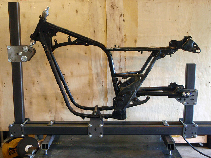

Here's an XS650 frame in the the frame jig after the various spacers have been cut to size:
Swing arm removed and Chop Source axle plates (style C with spacer plates) mounted:
Depending on what you're doing to your frame, you will need to fabricate more fixtures to hold and brace everything. This frame jig is just the basic platform you build off of.

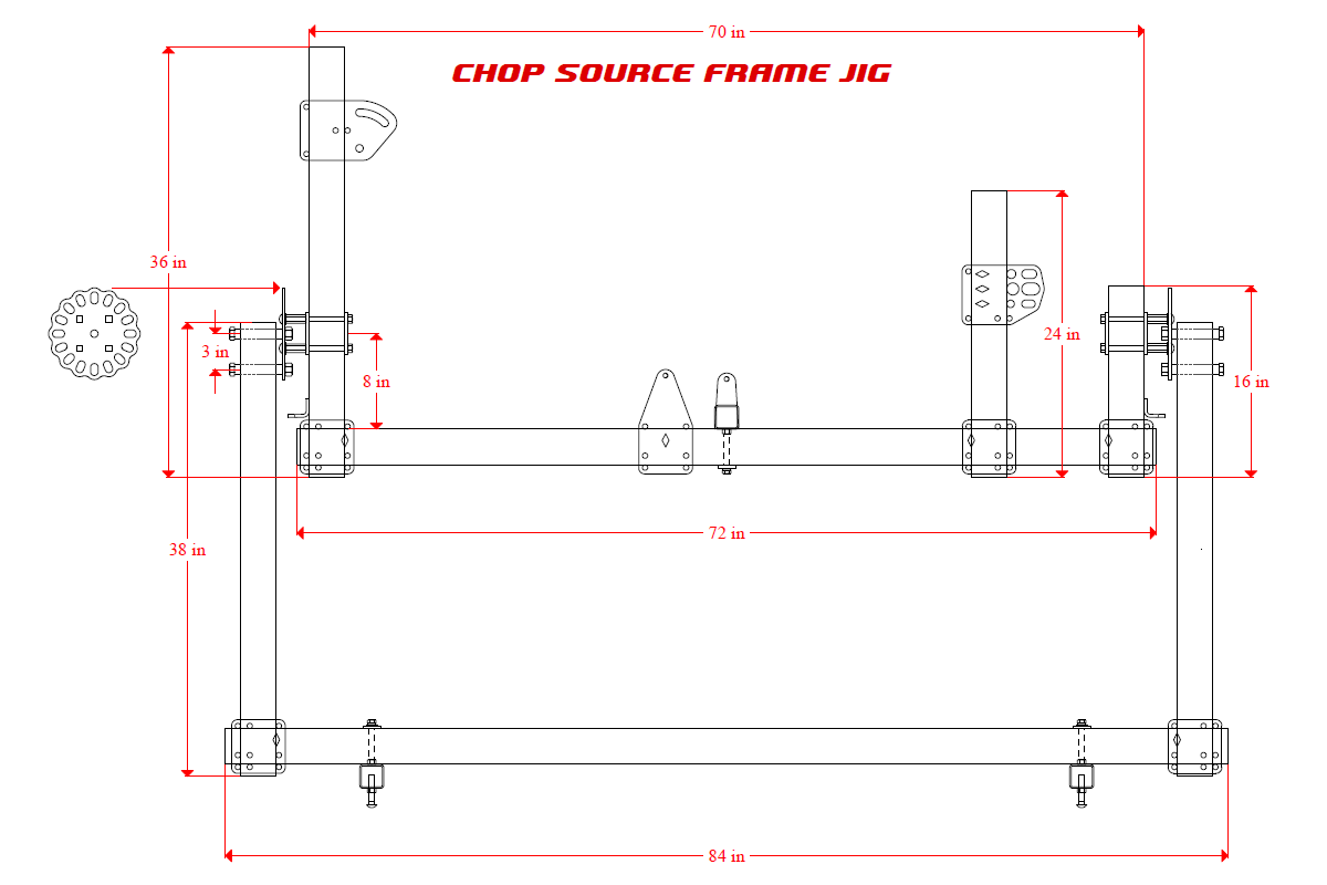

I have assembly instructions available with drawings like this. They are higher quality in the instructions.

Now you can upgrade to Stainless steel cones for an additional $18
2" o.d. - 3/4" bore.
