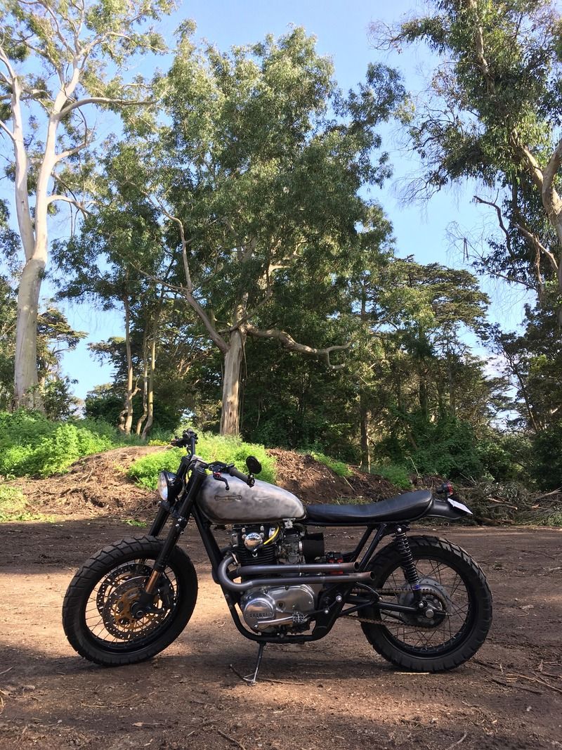

Took a brief ride across the Golden Gate Bridge and up into the Marin Headlands on Sunday after church while my kiddo and wife were napping.
WARNING - SELFIE AHEAD!
I stopped and poached a short dirt trail in Golden Gate Park on my way home today to get a couple pictures...
That inner aesthete is really bothered by the exhaust pipes being slightly out of parallel, but I think I can rotate them slightly in the head and fix it - just haven't done it yet. Too busy riding!
Front brakes are doing some very slight juddering under mild braking conditions, which makes me think I need to re-tighten and re-torque everything in the front end. Doesn't feel sketchy at all, and doesn't really do it under hard braking - kinda weird. Might be that the pads and rotors don't like each other, but I kinda halfway expected that with used pads + new rotors. We shall see.
As always, I've strongly appreciated the wisdom on this site - thanks to everyone that's steered me in proper directions. Much appreciated!

Well, it's been a while since I last updated, but I've managed to get laid off alongside 15 other people at my company due to capital market fears. Oh, well - I was planning to serve notice at the beginning of July, so they just upped my timeline. Whatever.
So, I've gotten a few things knocked off of the to-do list:
  • Replaced the starter/engine case seal - this was a colossal pain, but well worth it considering the bike doesn't leak a drop of oil now. In the process, I also...
  • Changed the oil to Rotella T5 15w40 standard dino oil. I accidentally bought T6 10w40 synthetic blend last time, and the clutch was slipping slightly. This seems to be working better. I also...
  • Replaced the copper crush washers on the oil drains, and the starter gear gasket in the process of removing/re-installing the starter. No more leaks! Not even small ones - great success.
  • Replaced all the starter mount bolts with longer, flanged ones. I am hoping they hold, because there's really not room to helicoil all four of them - maybe the two that are most easily accessed underneath, but it'd still be a pain. I used a healthy amount of blue loctite and torqued the bolts appropriately, so my guess is it'll hold just fine. I'll keep an eye on it though.
  • My seat came in today! I'll have to trim my rear fender a bit, and cut a slot into front of the electronics tray to mount it. It is beautiful, and exceeds my expectations. Well worth both the money and the wait. Horween horse hide with an off-white double-stitched tuck-and-roll pattern. Drool!!
Forgive the bad picture:
Still need to shorten the kickstand. Embarrassingly enough, the bike actually fell over while parked and the mirror + bar end dented/scraped the passenger door on some lady's quite new Acura TSX sport wagon. Me being the honest joe that I am, I left her a note. She called me, and my insurance handled it. Hoping my premium doesn't go up markedly as a result. That's part of why I pay a year ahead of time! Accidents happen.
Still didn't do the countershaft and clutch rod seals, but the 2Many 7005 aluminum one piece clutch rod is doing a remarkable job. The lever feel is great, and the neutral hunting doesn't seem to happen as I imagine the one piece rod is way less affected by heat. I'll change those seals when I install the modified worm arm. Meanwhile, they don't seem to be leaking too badly, so whatever.
Still haven't found a replacement tank, or attempted a repair on mine. Doesn't seem to leak much at all, so I don't feel too bad about it. Also still need to replace exhaust gaskets - I'll probably do that tomorrow.
