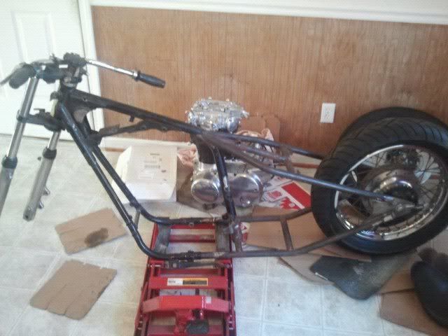

So I finaly got a hold of a title to start my buld with. It came with this already hardtailed frame, think I'll use it too. I knew it was long but the seller didn't know how long. I thought it might be a 6" stretch, turns out its a damn 8"!!! I mean I think its 8", it measures 36" from the begining of the the stock kick stand mount to the front most part of the axle hole. I measured another (stock swingarm) frame and got 28", so Im thinkin its an 8", correct me if Im wrong.
So Im not sure if I like the idea of an 8" stretch, mainly because I've never heard of an 8" stretch on a xs650. I'm trying to deside to go ahead with it or try to shorten it up. There is plenty of room on the axle plates (or whatever you call them) to drill a whole nother hole, cut the old one off and then it would look kinda like a G&L style hardtail (and I do like those)
Im just not sure if that would leave good room for the fender mount and seat springs and junk. Roughly it would be moving everything 3" up.
So this 5" gap would become 2" and I do want the fender to come all the way down to the bottom of the frame. Just can't deside....
It maybe more work than its worth, I wish I knew of some other 8" builds to look at to see if I like them or not. If you know of any please post links or pics of them here cuz I wana check them out before I deside to do this.
The top rail (like where seat springs would go) would be even closer than that bottom one (no pics right now, forgot to take that one this moring and Im at work now) but I guess I could move the whole seat mount up if I needed to (he did an odd job on it anyhow)
desisions desisions, I just don't know.....opinions welcome.

Putin this pick up to show how long it is, I think the other pic was a bit angled makin it look a bit shorter.
http://i1235.photobucket.com/albums/ff422/SteelToeJoe/xs9.jpg
