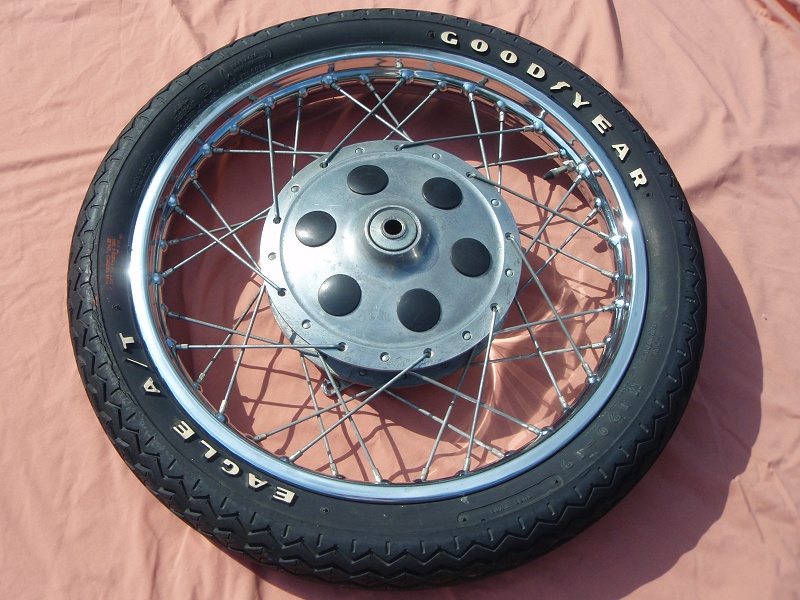

  4. If you want original looking wheels, you'll need a drum front wheel like this:
    [​IMG]
    [​IMG]
    I just sold this in the Classifieds :(

    - if you want a drum front end, the SR500 has one that is almost a copy of this - it has only 5 holes instead of 6 RHS, and the air vent LHS is different...
    - it also seems to be more effective as a brake than the original...its made to fit however a later 35mm fork, use spacers - and requires the retaining bracket if using later forks for the 298mm disc
