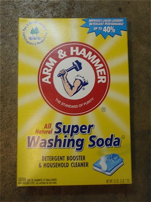

This is what you want to use, Arm and Hammer washing soda. As far as I know, it's pure sodium carbonate. Don't use baking soda. It's not the same. I went to several stores looking for it but the only place I could find it was at the grocery store. You don't need much. About ¼ cup in the tank should do.
