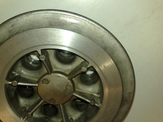

- 4.4mm gained from turning approx 2.0mm from the inside surface of the boss and approx 2.5mm from the inside surface of the pressure plate
- 2.5mm gained by removing 1.5mm from the bottom of the boss and1.0mm from the outside of the pressure plate
- removing the 2.5mm from the boss underside requires filing the friction plate dog spaces in the basket
- use the pressure plate with the teeth and make sure that the teeth locate into the boss splines at all times
...2.0mm removed
...side view
...1.5mm from the bottom
...file to fit
...so
...2.5mm thinner
...1.0mm for clearance
...complete
