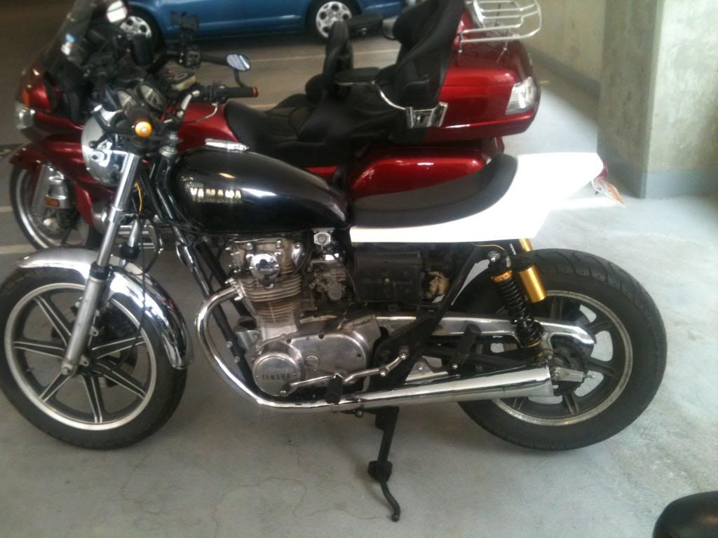

Hi guys, been a lurker for some time, now that I have a couple XS650s I figure I'll be here a bit more and should participate..

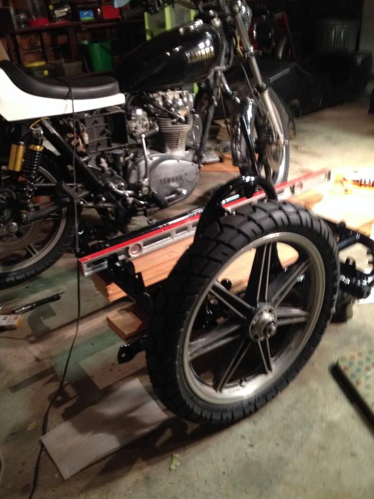

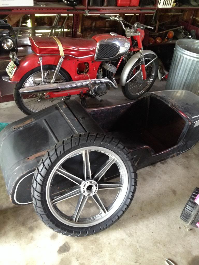

Two summers ago I picked up a Dnepr (Soviet Military Bike) with a sidecar. Ended up selling the bike and keeping the sidecar, decided to mount it up to the XS650 ('81 Special) I had kickin' around.
Here's a couple of pictures of the bike and the progress with the rig. Just finished some 2-1 high pipes last night, other than header coating. Waiting for a piece of bent thick wall tubing for a subframe for the rear sidecar lower mount and then I will put the tub on the frame and hit the road to see what I can break.
Anyone with sidecar experience please pitch in and if you see something I should be concerned about or have questions on the work I'm doing. I am a complete novice when it comes to sidecars :doh:

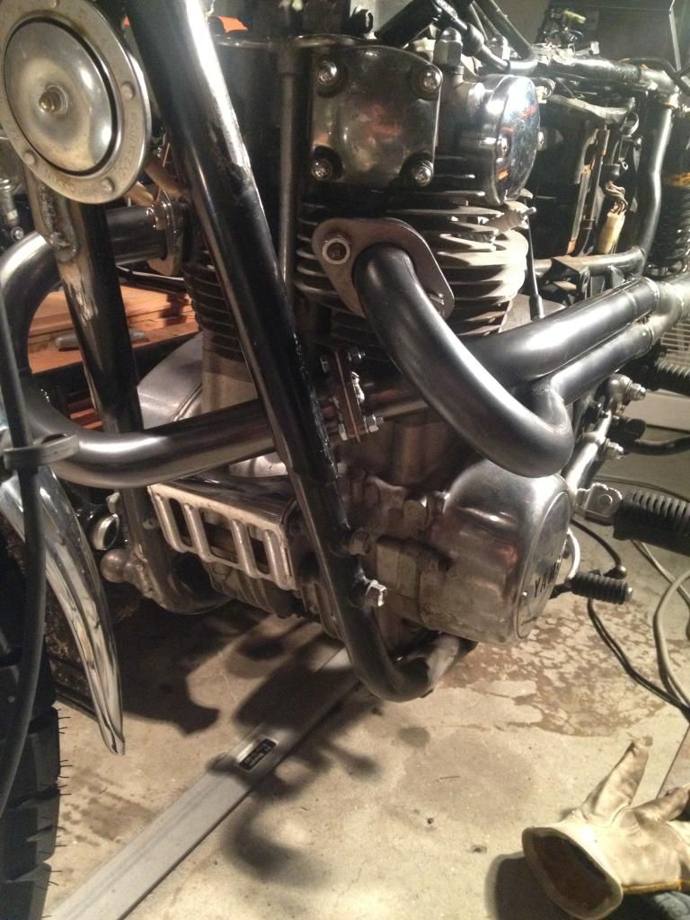

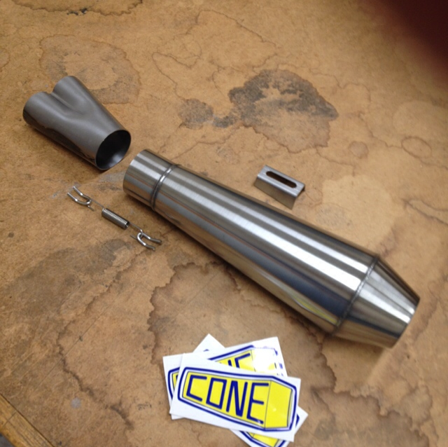

Thanks, the exhaust was a bit of a rush job as I wanted to keep the exhaust on the left side (away from the passenger) and couldn't find anything available like that. Gordon Scott makes some great ones, but isn't taking orders right now..
You could buy one of the few xs650 bend kits available and save a few bucks. I already have a lot going on and want to get on the road ASAP so I used the Pandemonium Choppers "Ya Mamma" pipes combined with a 1.5" inlet to 2" outlet 2into1 collector and a 2" inlet stainless steel baffled muffler from Cone Engineering. In between the collector and muffler I added some length with 2" OD tubing.
The spring and retainer also came from Cone. Because I welded the headers to the collector, I had to made a butt joint on one of the headers with flanges and a gasket so the pipes could come off the bike. I'd suggest finding a slip on collector and using springs to hold it on so you don't have to do what I did.
I'll list prices and parts when I'm at a computer. I do have an extra set of 1.5" ID flanges if anyone needs them.

Nice looking work. Love the pipes, but maybe a bit of potential for some nasty scars without a heat shield?

Don't know how much you have been thru, but here are some things to watch for...

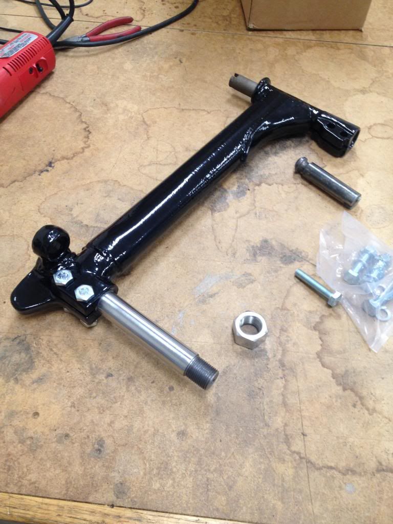

Watch those ball joint mounts. Most folks replace them sooner rather than later with something a bit more solid. The DNEPR is a heavy rig for the XR. Your attachment points bear watching close as well, until you get a few thousand miles on it. I had to move mine around a bit, and after a couple hundred miles had some cracks develop in the hack sub-frame that required larger gussets. Definitely heavier fork springs, shock springs, and maybe longer shocks. I think you'll prolly want to gear down (bigger sprocket on the rear), as you 1st gear will be hard on the clutch.
May need to reduce trail (modified trees) if steering is too heavy. Most go this route, once you decide that these crazy three wheelers are here to stay. Alternatively, a set of Leading Link forks is mo-betta, but hard to touch at less than about $2k. I ended up with a steering damper on all my rigs.
Once you get around to pretty finishes, LINEX is superb for the inside of the DNEPR,as well as the bottom.
Nice choice of tires, and fitting the XS wheel to the hack was a great idea. May want to fit the brake over there eventually as well...
Jay at DMC Sidecars in Washington State and Claude at Freedom Sidecars are both very helpful with set-up questions, and have lots of hack related mounting hardware.
If you take any trips... take gas. Your new mileage will suck. The XR1200 got 40; it now gets 25. The GL1200 got 40; it now gets 25...:doh:
You'll may go through clutches fast. The GL1200 clutch has 25000 hack miles on it, with the stock clutch. I have about 5,000 miles on the XR/Ural rig and have been through 4. Go figure. When we travel on the HD I always take a new Barnetts clutch pack with me... and lots of tools.
Last, watch your handling at speed. Doing 70 going down the freeway on a smooth surface is fine; but a patch of unexpected rough road will have you clamping on the binders real quick; hack handling can get squirrely fast. The toe-in makes a big difference at speed, and for tire wear.

I do have a few choices for exhaust heat shields and will mount a 12" or so wide one when I can make up my mind.

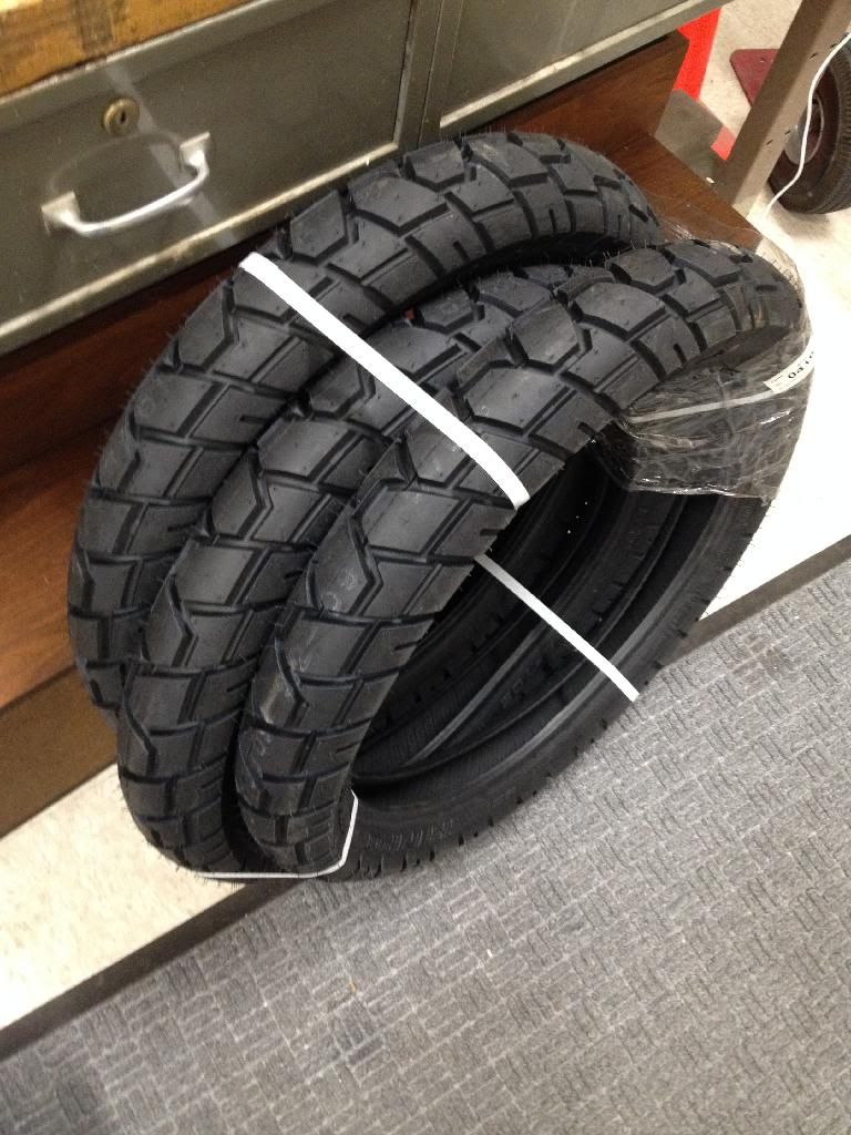

So far I've replaced all wheel bearings and tires, converted the back wheel to a 19" front to match the other two. Using tapered roller bearings on the sidecar wheel, in my experience they hold up a lot better to side forces. Geared down a bit when I did the wheel conversion and upgraded to a o-ring chain. I have two spare wheels I can mount to the back of the rig.

No sweat. You have some great welding skills. I end up fabbing, tacking, and then taking to folks (whose life I place my hands in...) for quality welding. Make no mistake that the forces hacks impose on bike frames are substantial; steel failure at speed can be fatal...

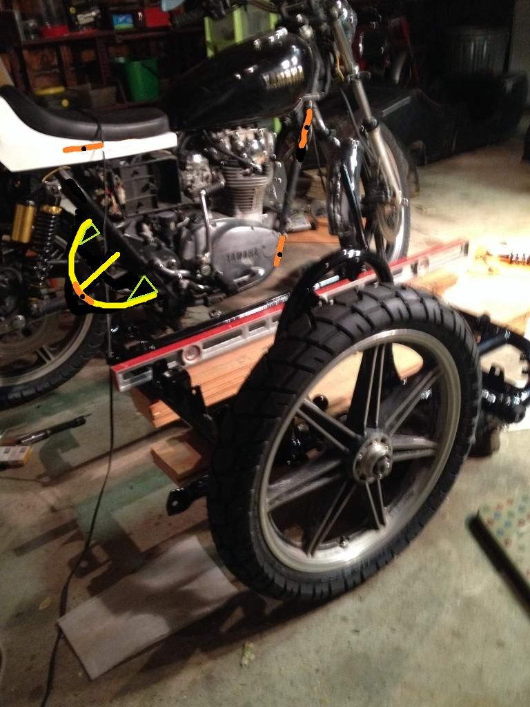

The first moment of truth was releasing the tie-downs that were spanning the garage and holding up the bike. Letting the sidecar frame keep the bike up..

Which is why I am a little surprised at the appallingly poor quality welding of that sidecar bracket ?:confused: I would have got that critical welding done by a professional with Tig equipment, the prospect of bike and sidecar parting company at speed doesn't bear thinking about.
