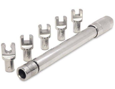

I'm also probably going to buy a spoke torque wrench like this:
They are about $125. Some of you guys will probably say you don't need the torque wrench but I haven't been building wheels for years and don't have the ear for the "ping" of a properly torqued spoke. Plus I like new tools. :D

If you have access to a welder, you can build your own wheel stand [basic dimensions are on my web site (linked to in a prior thread)]. Don't bother with that fancy spoke wrench, get a Rowe, about $8 now. I've yet to find a spoke it won't fit. Spoke torque wrenches are pretty much useless except to get you "in the ball park" as far as tension goes. Here's an old thread from another list that explains the wheel work pretty good. This is for all members EXCEPT INXS - DON'T YOU EVEN LOOK AT IT !!!!!

That's some good info on building wheels. Regarding the spoke torque wrench, I don't know what "in the ball park is" so it would be good for getting the spokes to the “proper tension” then making adjustments to true the wheel from there. :shrug:
